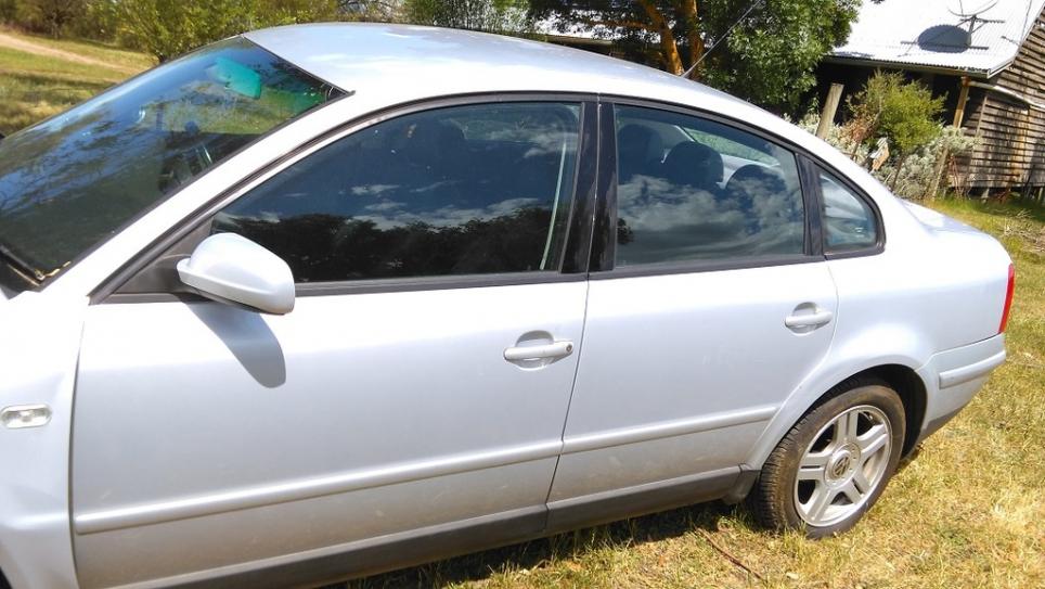

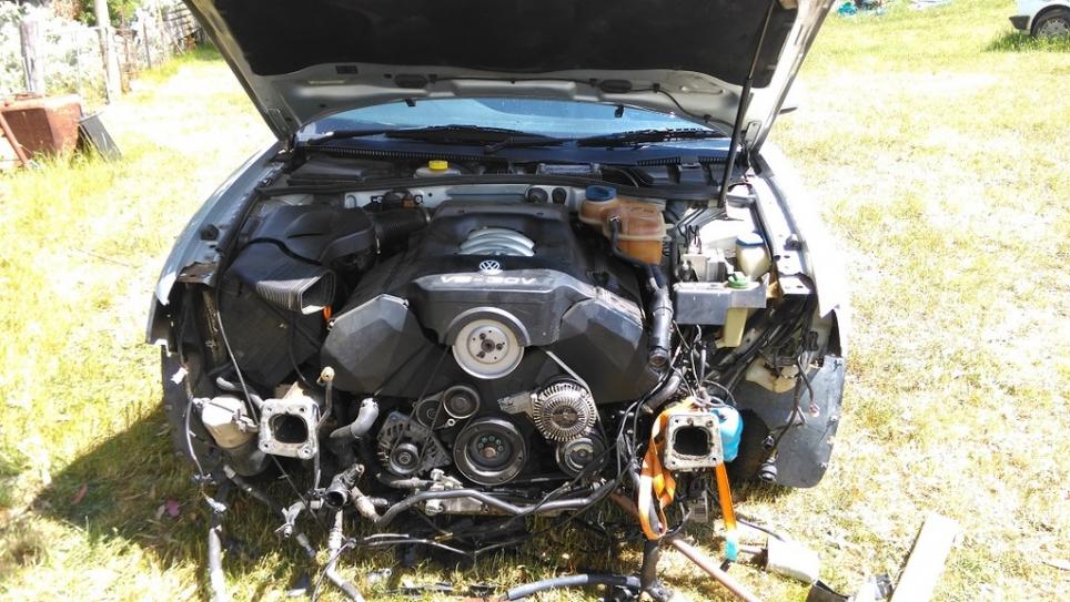

    Now that is done starting a new project which is going to be a mid engine single seater that uses a V6 and Transaxle from a 2000 VW Passat.

    The next project donor Passat

    What is the drivetrain setup of the donor passat?
    Looks like a big engine.
      Going to be N-S using the auto still. I like to avoid cracking open parts to make mods, in this case installing a manual box - etc etc.
      Two issues with using the Audi/VW set ups is that the output of the half shafts is really low off the box, meaning the engine has to sit higher if you run low ground clearance. The porsche transaxles can be rotated but VW/Audi cannot.
      The 2nd is that engine is large as you note and is actually really close to the outputs as well, which is an issue in my case as it wont fit under the desired body work, so going to need to make the engine covers part of the body work. Not the end of the world but annoying.

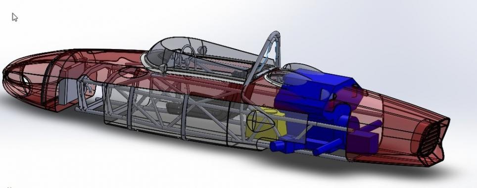

      A screenshot, still very much a work in progress as i lock in suspension points and then bring the frame around to suit it + the engine.
      Currently have MX-5 uprights to go all round but looking at changing to Golf Mk4's, which - should - allow me to use the short near side half shafts unmodified and allow for identical suspension all round as i convert the McPherson strut to double A-arm. Did this to BMW E36 uprights for the Lotus 7 replica by using machined inserts with a thread cut into the center to attach a rose joint.
