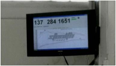

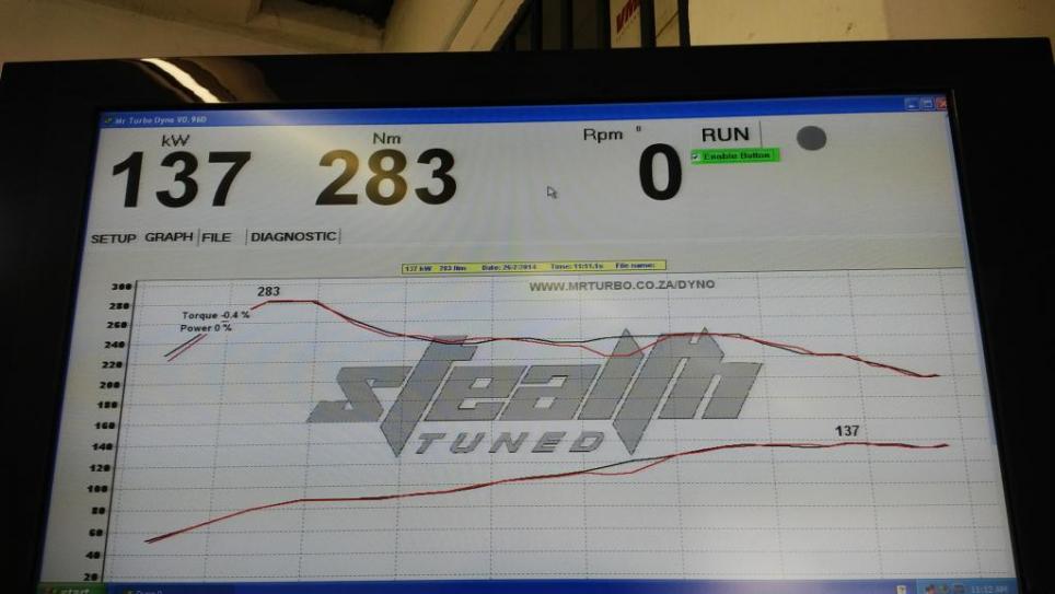

    137kw & 283nm - 3rd run (First two runs were 137kw & 284nm)
    131kw & 251nm - Straight pipe exhaust only (126kw & 251nm with full stock exhaust)

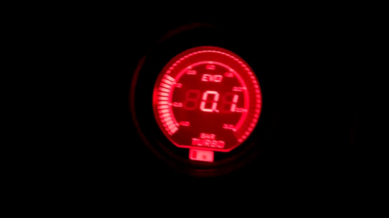

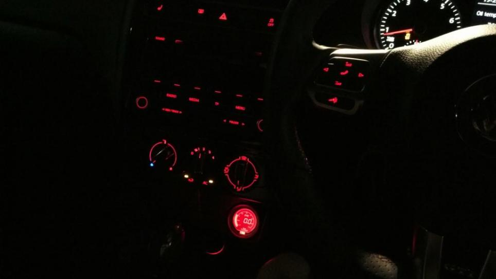

      Boost gauge
      2013 VW Polo 6R GTI - CTHE
        2013 VW Polo 6R GTI - Boost gauge
