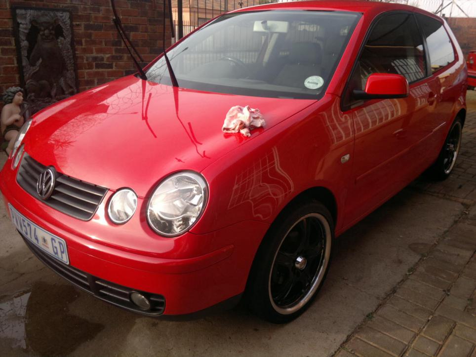

    I'm all the way from South Africa, I drive a red VW Polo 1.9TDI, 2004 model,
