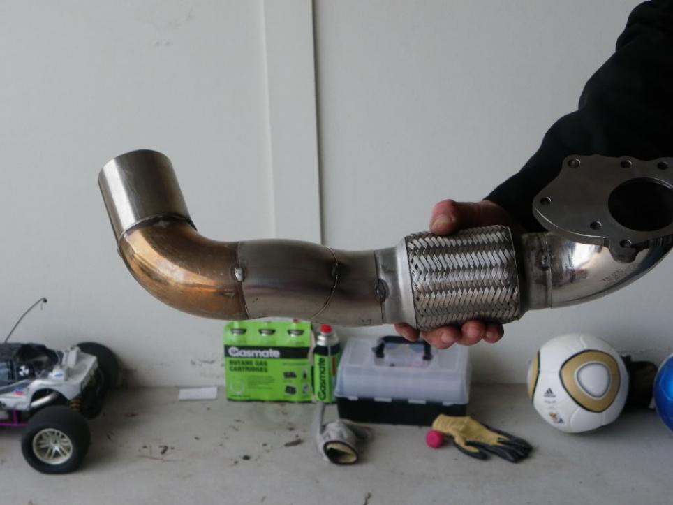

            this is the down pipe that is ready to be welded.

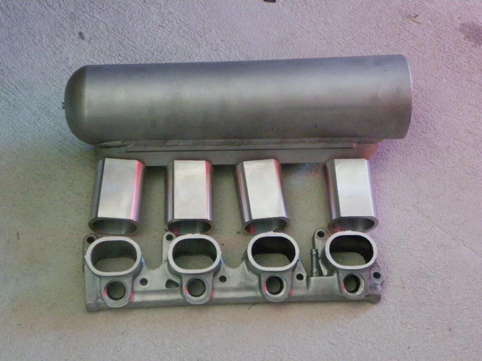

              Intake machined by my friend Andries Venter, ready to be welded.

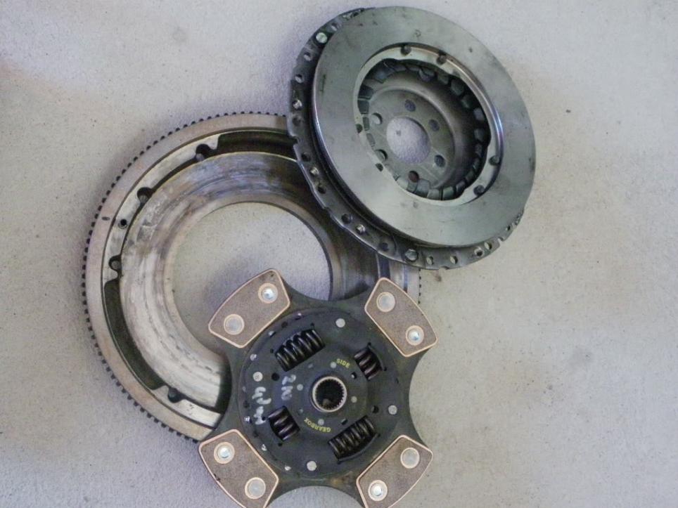

                button clutch.

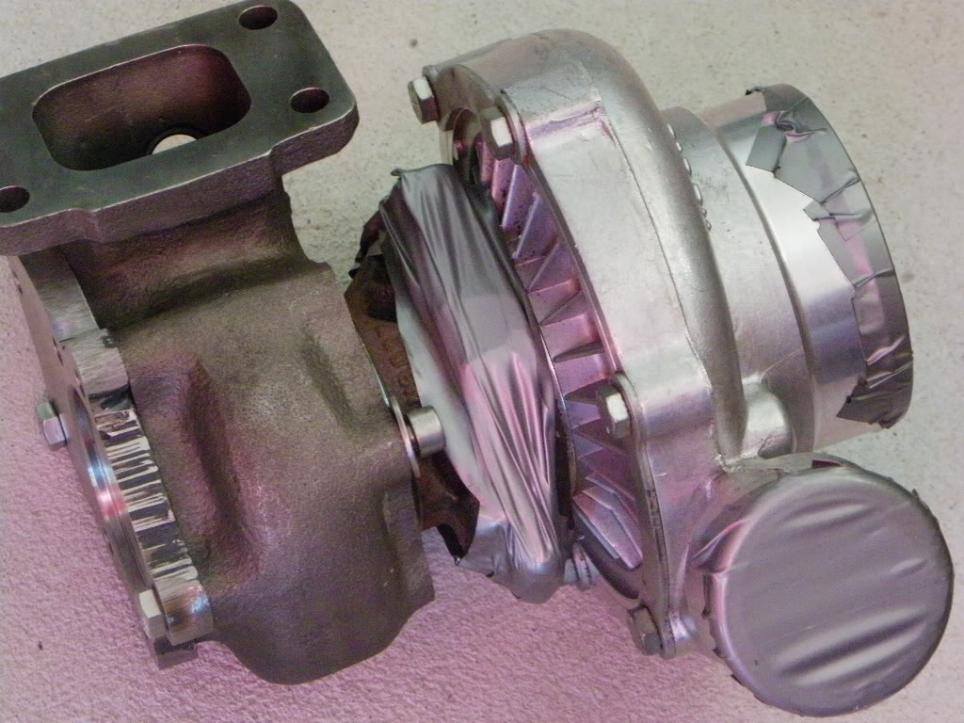

                  Turbo ready to be fitted.

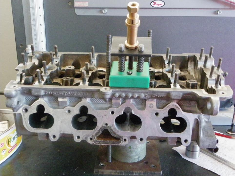

                    cylinder head on flow bench.

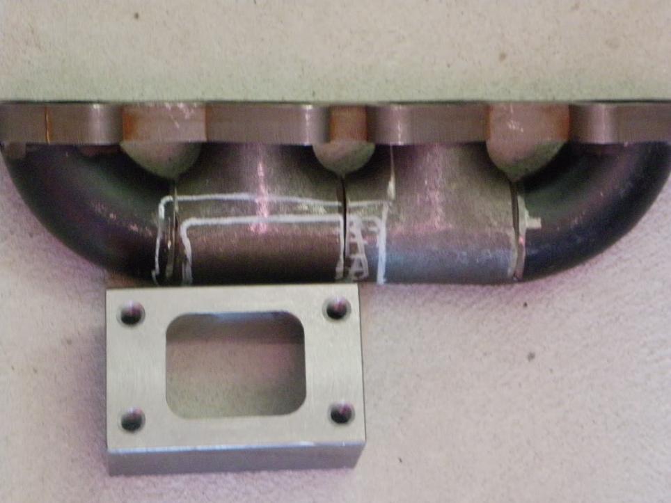

                      Log manifold ready to be welded.

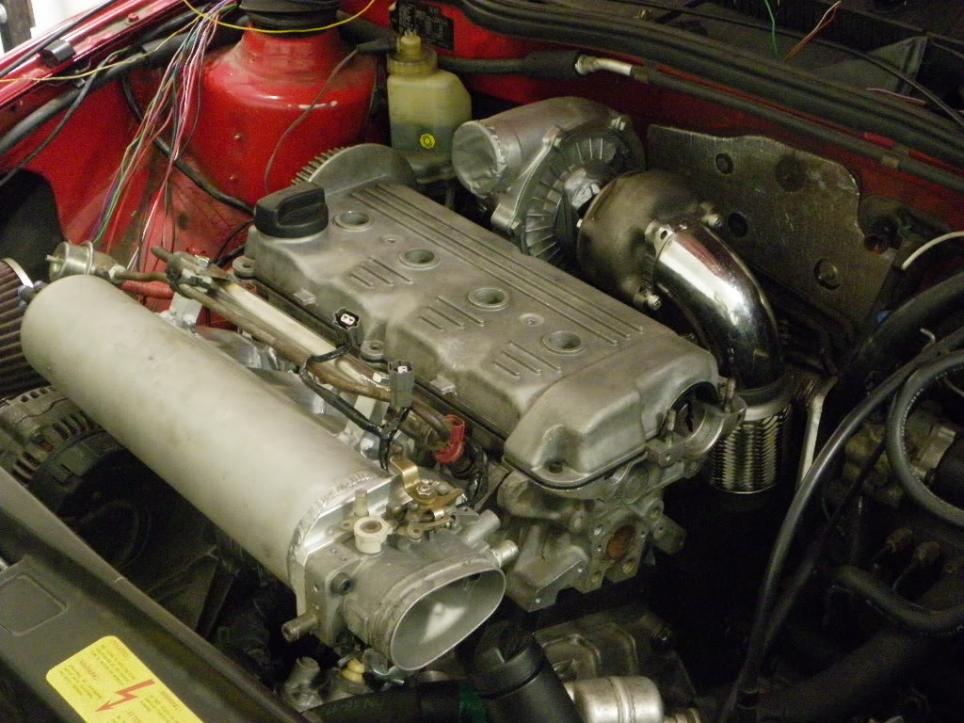

                        engine fitted in Seat with down pipe and intake fitted just to check if it all fits in perfectly!

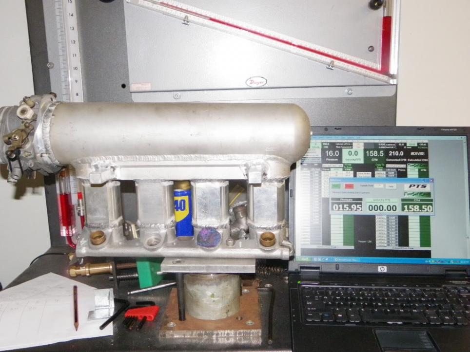

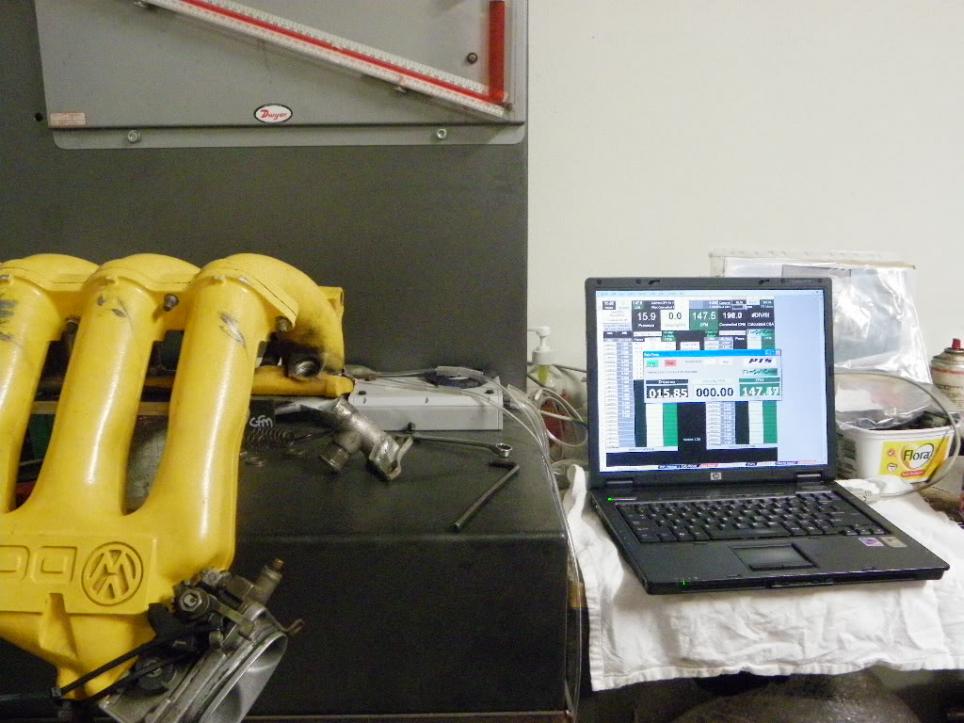

                          new intake welded by bunbury headworx and tested on flow bench.
                            standard intake on flow bench.
