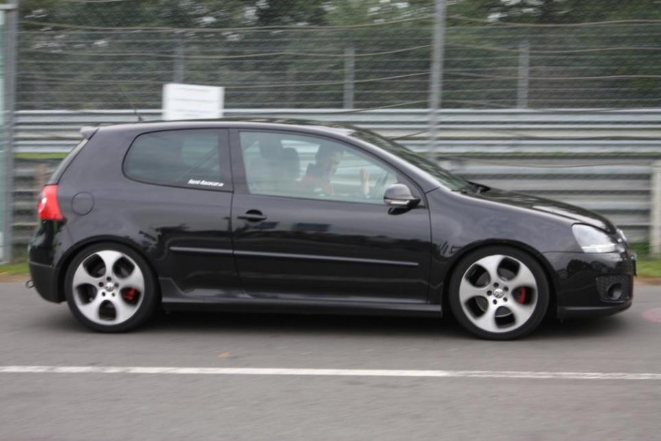

    I drove the MKV GTi at the Nurburgring (Below) and was pretty impressed with it!

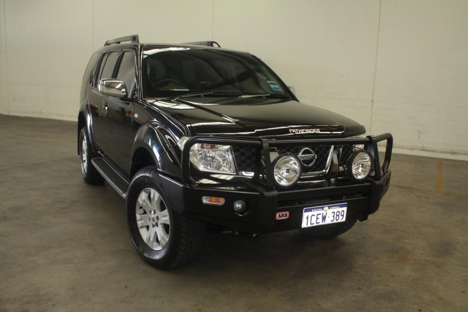

    I was going to buy an R36 Wagon, but I cannot get the Mrs out of her Pathfinder which is due for replacement soon as we have two kids and we 'Need' 7 seats!..?
    Still I have fun in it
    so I figure she can keep that till it dies and I'll get the Golf GTi instead

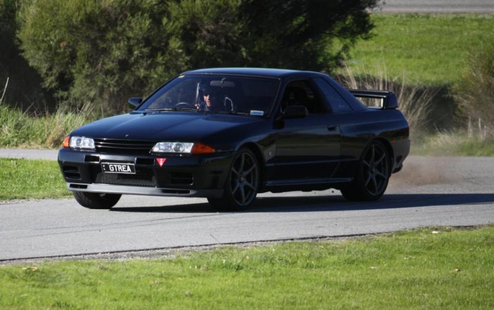

    I also have an R32 GTR
    But it rarely see natural light....infact I think its service intervals are every 6 months at 0kms!

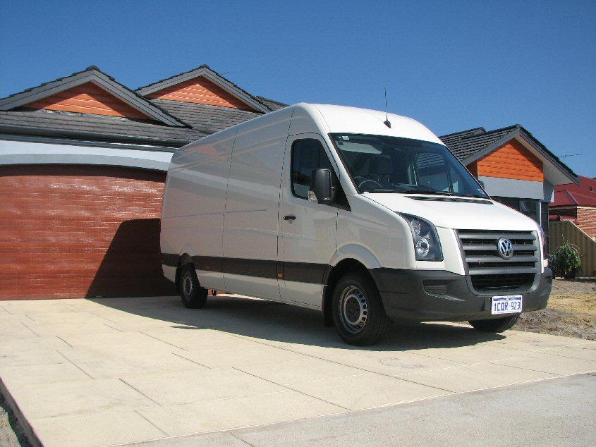

      Dont have to many of the Crafters unfortunately.
      This ones a 2007 Crafter 35 LWB 100kw 6spd Manual......as this was the 1st Crafter I ordered I originally specced it up with everything ie 120kw, 3 seats, driving lights, overhang etc etc.....but the wait was getting rediculous so instead I just had to take this rather basic one from stock in Melbourne.
      Electrics / lighting seems to be a problem with it, as I have been thru maybe 10 -15 headlight globes now, 5 or so clearance light globes, a few pan light globes, 2 sidelight globes....and one indicator globe last week.
      VW say there is no problem however.................
      Other than that a very good van........heres another (dodgy) pic I took when someone suggested his Hiace 6.0 was a big van.......ummm......No

              There has to be some sort of electrical spike / short somewhere?
              It affects nothing but the lights.....I just bought another 5 x Headlight globes for it which reside in the glovebox (about $15 a pop from Supacheap)........I have changed that many now, although I can do it in the dark in under a minute....the connector is getting very loose and bent
                Message received Thanks Ben;DRL burn outs globes headlamps etc is an indicator of the incorrect filament may not be the exact bulb so post numbers and I will match them up to OEM
                I'd be interested as to which country they are manufactured in the print is on the bulb.
                However Voltage spikes may be evident under-load and is a possible indicator as to brown out's
                Test your voltage when lights of and nothing else is running at alt 14.2v full charge.
                Turn lights and Drl's on and watch what is spiking on voltage if dropping below and staying at 12.4v down to high 11's then either your original battery is on it's way out or your alt may not be fully charging.
                Suggest you go to a beattery shop and get a full prognostics check on both battery and alt trough it's charge holding sequences as to it's overall condition.
                Note: providing you have not tapped into your Crafters electronics and added something else such as extra lighting internally,I'd suggest the wrong bulbs are being used.
                This shows up consistently in the N/A NAFTA market in Winter periods in part heat on cold can create a premature failure due to extreme temperatures inside outside, again wrong bulb by wrong manufacture =poor quality or wrong wattage etc.
                Sorry no pics or PDF's as I do not use a third party after-link such as image shack that can not be uploaded from my pc direct to the forum. PS aviator what's a dubber:>?
                Richard

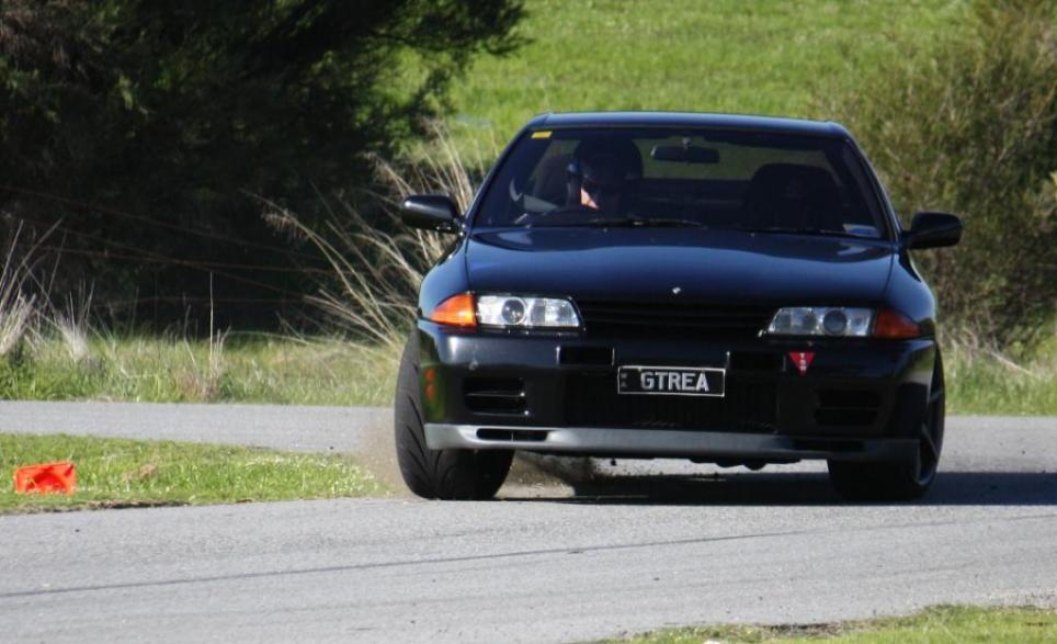

                          are the gtr pics from a superkhana? (speed dome?)
                          I've done a few of those
