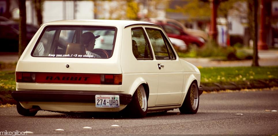

    and i have a 88 y31 cima drift car,and on my drift forum i use we post pics of cool cars, and the other day i saw a pic of this
    now i couldnt find a rabbit in aus and then realised they were just mk1 golfs, so now i am looking for a 3 door to do something similar, not a crazy low, but will be close,

    a little info on that car is that its on airride, thats the only way to get it that low, small wheels and tyres lots of tyre stretch and alot of frame notching, strut tower raising.... but all worth it, hence that awesome pic
    coilovers will get you relativley close to that, but airride low is another extreme

      thanks heaps for that mate! where do i find coilovers and how much, also have you got any pics like that car with coilovers instead, and what are common problems with lowering this car that low? and also camber controlled by adjastable camber arms in the rear? sorry for all the questions, im in the process of reading as much as possible, i also read these are kinda quick or what they are!
        well basically, the rear end has a single beam with rear drum brakes mounted to it, kinda like a torsion bar, so the lower you go, the closer the front of the wheel gets pushed to the front of the guard, also to make camber on the rear you need camber shims, basically angled plated that bolt in between the rear beam and brake system, the beam itself is not camber adjustable
        coil overs can go from $700-$3,000+ depending on how serious you want to go, if you like ride quality, get coil overs with adjustable dampening shockers, they cost abit more, over the $1,000 mark
        hopefully that answers a few questions, shoot some more if you want
