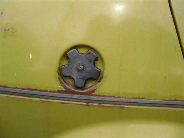

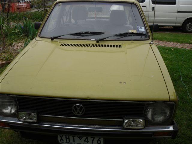

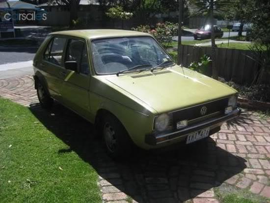

    Now the bad news... it's got a bit of rust haha. I'm not too scared by it but i'll let the pictures do the talking:

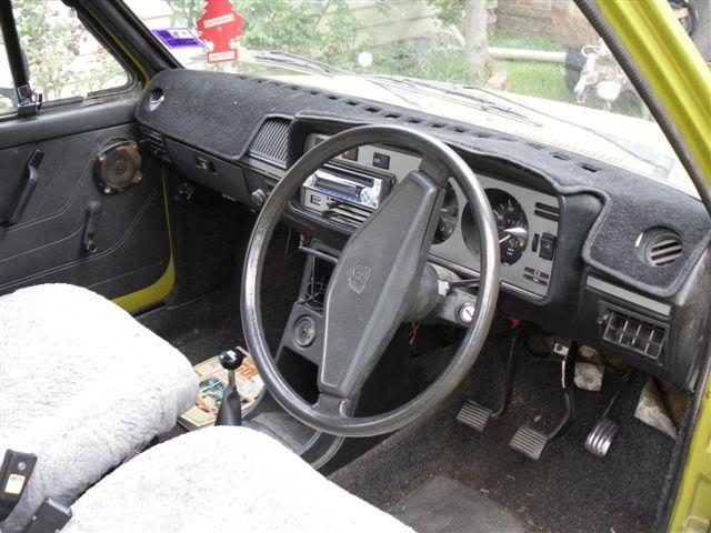

    I was pleasently suprised by the interior. Not too bad at all I dont think:

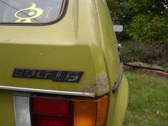

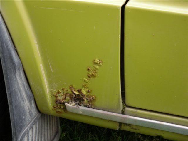

    Ok here we go with the rust.. This looks ok, but it gets worse.
    Alot of it just looks like surface rust Which is no big deal. But I'm hoping it's not too bad undernieth..
    I have limited welding skills (have a small ARC welder at home). I'd like to have a go at fixing some of the bad stuff myself -eg. the lower front wing (I'm hoping that's the worst).
    At the end of the day though. I really don't care if the cars not perfect, I just need a cheap DD that I won't **** my pants if it gets scratched or gets a door ding. I'm kind of looking forward to the challenge of rust repair. I've done a bit of body work on my e30s but nothing to big for fear I mess it up.
    So what do you think^? $500 sound like a good deal? I'm going to check it out and take it for a test drive on Tuesday so I'll let yuo know how that goes!

    Welcome aboard, That Mk1 looks alright for the price.
    With regard to the rust, I'd be more concerned about the stuff you cant see. All the rust in the pictures above are easily fixed. I'd probably replace that guard rather than repair it, you can still find rust free ones.
    You need to take a good look under the front carpets and see if the floor is solid. The base of the A pillar where it meets the sill and floor is another trouble spot. Check the inner wing too, from both under the guard and from inside the car. Rust in this area is structural and if bad enough pretty much seals the fate of the car.
    The rain tray is another area to check as the the firewall and inside the boot.
    If it all looks good, go for it! (At $500 you might even consider this one for parts if it turn out to be too rusty to put back on the road)
