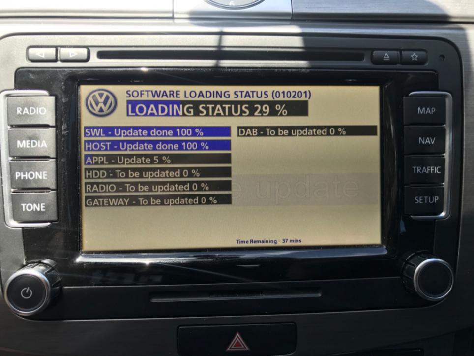

      Cheers dinot81, I will give it a try tomorrow morning. A bit more background info here. The factory RNS 510 (1T0 035 680 T; HW H23; SW 6270; B 17.01.2014) in my 2014 VW Passat now stuck at the VW World start up screen and in a reboot loop, it went wrong after the mechanic changed the water pump and auxiliary belt for my car last week. There was a movie dvd in the head unit at that time and I then took it out, but problem remains. I then did a lot of research, downloaded SWL and firmware 6276 ISO from Volkswagen RNS 510 Firmware Download Repository | my-gti.com, burn them on to DVD-Rs with slowest speed, put it in the unit with pressing the left, right, eject and star button at the same time. The unit seems to be loading the disc and restarted a few more times, but still remain at the welcome screen without any scripts. I also tried disconnect the battery for 10 mins then connect it back, (did not do your trick to drain the battery though), did not help.. If you could think of anything else or know where I could send the head unit to get it fixed, let me know too. Cheers..

        If you have the dvd burnt already, try this:
        1. Open car, do not put key (remote) in ignition
        2. Turn on unit, hold "eject", "i or star button" and "setup" until the syatem reboots into "Load SWL Disc" mode and then insert disc and follow on-screen instructions. Might take up to an hour and eject disc to restart unit.
        Unless Oz version is different to other cointries, maybe worth trying.

          Hey Dinot81, you are the champion!! Did your drain battery drill and got it loaded up and now head unit back to life! Much appreciated mate!!!

                      Sadly, it didn't get past the "SETUP SOFTWARE LOADING APPLICATION" the green progress bar was maybe 95% complete.
                      Should I try again and wait a longer? (waiting around 30mins already)
                      Is there drawbacks with downgrading to FW5238? Losing Map etc?
                      I was hoping if i was upgrading to FW6276, it would solve my stuck on welcome screen issue and retain Map data.
