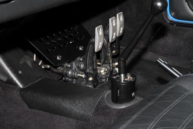

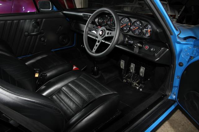

          The pedal box, and Momo Prototipo wheel with quick release mount custom made by Michael at Promotive.
          The custom adjustable Tilton Pedal box and custom made backing plate. The pedal box is adjustable in reach with two positions, mine and the stock position further forward if someone taller wants a drive.

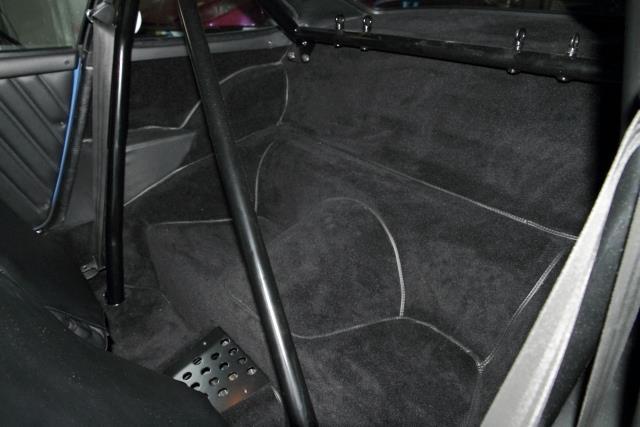

          Rollbar reconfigured to match angle of B pillar and powder coated the same as the IROC cars were & shift linkage panel cover powder coated. All Interior trimming by F&H Motor Trimmers using Porsche Silverknit carpet in RS style
          Some of the trimming work by F&H showing the seat belt covers he custom made and covered in leather

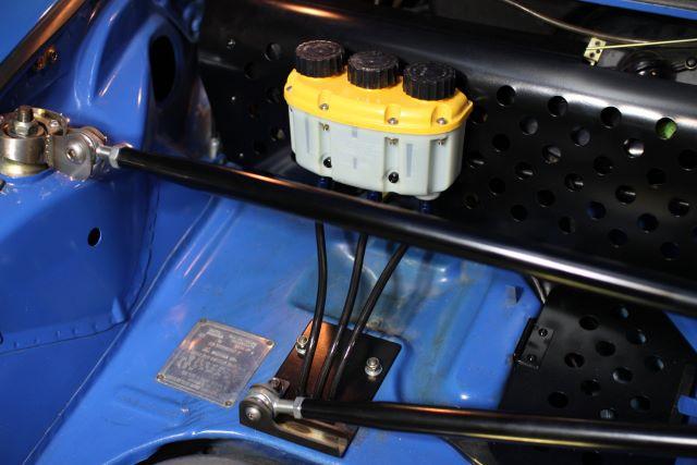

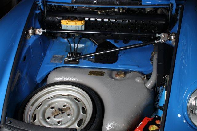

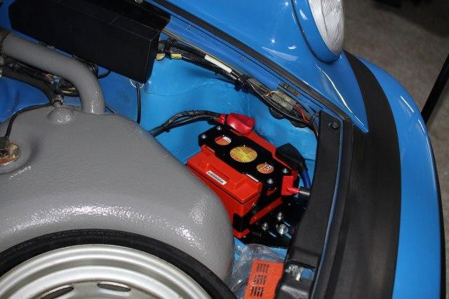

          New master cylinders mounted to powder coated blower motor cover. Also powder coated strut tower brace, smugglers box cover and powder coated odyssey battery mount.
          Close up of master cylinders and beautiful new braided lines. All lines were changed out for braided. The clutch was changed from cable operated to hydraulically operated as well.
          Odyssey battery mount powder coated.

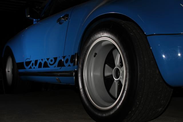

          The beautifully refurbished wheels from Melbourne Classic Road and Track

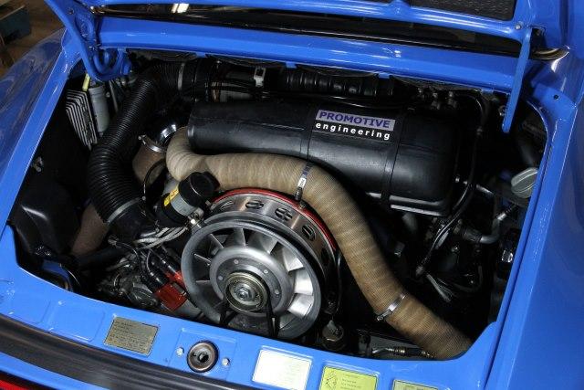

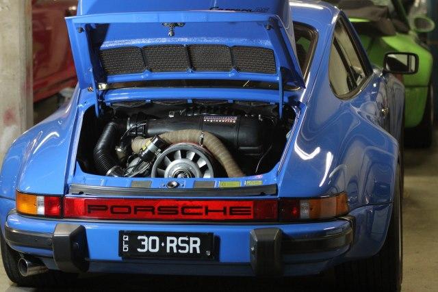

          Engine bay clean up and a few tweaks to the engine by Promotive
          Great shot of the arse end.
          The paint is in fairly good condition but the whole car will be resprayed once the front and rear IROC bumpers and whale tail are fitted.
          Here you can see how the rollbar runs in line with the B pillar as the original IROC cars did.

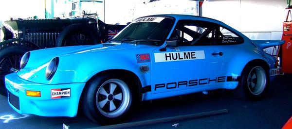

          Denny Hulme's 74 911 RSR IROC (International Race of Champions) It was a racing series in the off season to F1, Indycar, Nascar and Can Am Sports car racing that Roger Penske started using equal 911 IROC's for the first two seasons before they changed to Camaro's. Drivers included Denny Hulme, Emmerson Fittipaldi, Bobby Allison, Mark Donohue and many others.
          We are trying to emulate this car in performance and look when my car is finished, though without the sponsor logos.

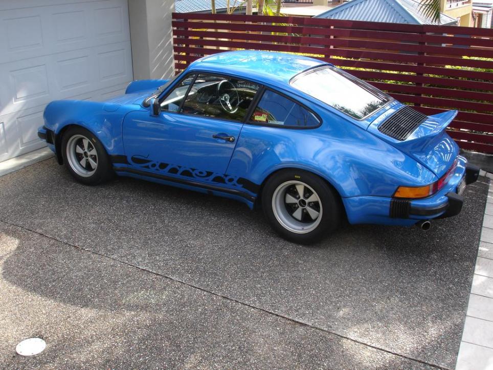

          Current exterior shot of my car. If you compare it to the previous Denny Hulme IROC image you will see I need to replace the front and rear bumpers with the light weight non impact ones and I will use the whale tail for track days and keep the duck tail for the street. We will have a quick release system for the deck lids so they are easy to change out.
          Originally the first 12 cars came from the factory to Penske with the ducktail but they found it had too little downforce so changed to the whale tail.
          I will also have the car completely resprayed in the current original Arrow blue and get rid of the rocker sills as well as replace the Carrera decal with Porsche decal.

          • #20
            Holy sheet. Looks incredible! Totally in love!
            What size are the rear tyres?
            What kind of weight will it end up being? And what kind of power figures?
            Seriously, I love your car. Would love to see it in the flesh one day. The pedal box did funny things to my insides.

                Thanks, still a long way to go but its getting there.
                Wheel Sizes are 15 X 8 front & 15 X 10 rear
                Tyres are Michelin TB 15 tyres – 270 X 45 X 15 Front and 295 X 40 X 15 Rear. They are the only ones who still make a 15" in the right sizes
                Currently around 1160kg, still a light weight wiring loom to go in yet and the heavy front and rear impact bumpers will be changed out to the lightweight IROC racing ones as well as a lot of other things being deleted so hopefully just north of 1000kg when we are done.
                No current dyno figures, we haven't had it out of the car yet to put it on Michaels engine dyno. When we are finished with the engine and trans work I would hope it will be north of 300hp and 3.2 litres instead of the 3.0 currently, which with the right gearing and the LSD will be more than enough fun.
