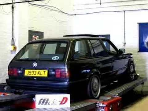

YouTube BMW e30 v8 dyno. That's my old touring which I wish I brought back.

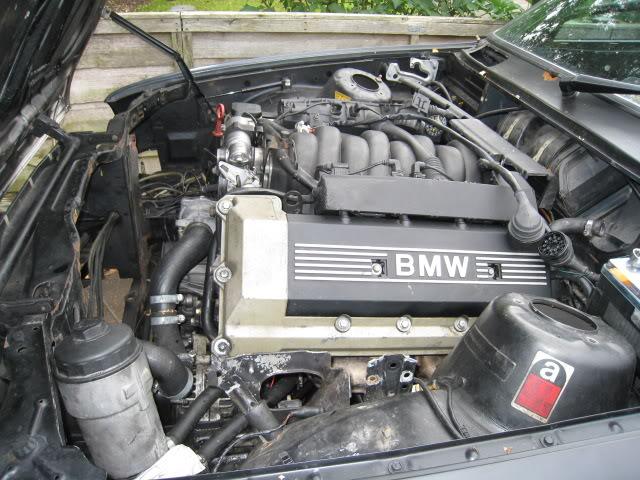

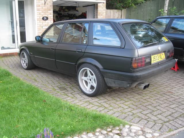

Specs:
635csi leather Recaro seats
E30m3 5 stud conversion

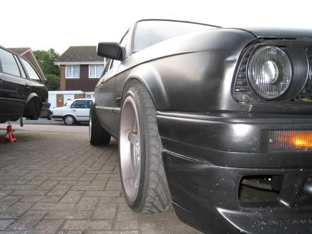

BMW system II WHEELS WITH DUSTBIN LIDS 17x8/9 et 24/15
m60b40 plus manual box from a 740
Full racing dynamics body kit
Blistein b8 shocks with H&R -40 springs
Fake suade interior
Smoked lights f/r
3.15 lsd diff, though had 4.1 in there at one stage which made 1st and half of 2nd useless!
Used to keep blowing driveshafts until someone told me that the z3 diff swap needs the e30 flanges!
Other wheels I had were Rondell 058- a kind of BBS knock off but 17x9.5 et 10 all round and Racing Dynamics 17x8/9 et23.
I miss that car! Would play tag with porches on the m1 and have a blast!
