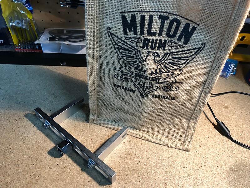

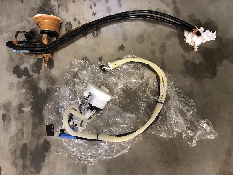

        I finally got around to replacing both fuel level senders. not such a bad job but a bit fiddley pulling the pipe over the prop shaft tunnel to the other side of the fuel tank. I forgot how much I hate working with fuel tanks after replacing a couple of pumps on my s3 and r32 in the past...
        having the right tools always helps (no not the rum...), the pronged gadget is for removing the fuel pump collar. it has a 1/4" and 1/2" socket drive that you turn it with. much better than a screwdriver and hammer which is my usual method...
        fixed and full...
        for anyone reading with the same issue; i tested the ohms and it was approximately 900 ohms on the new unit when the float is up and about half that on the old unit. hence the reason i was only ever reading 3/4 full on a full tank as the other sender was reading approximately 900 ohms too...

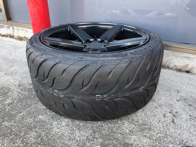

          I decided to get some sticky rubber on a spare set of wheels before a short track session at lakeside. I'm not really a fan of the wheel style but they will do as a spare set with some nice semi slicks on...

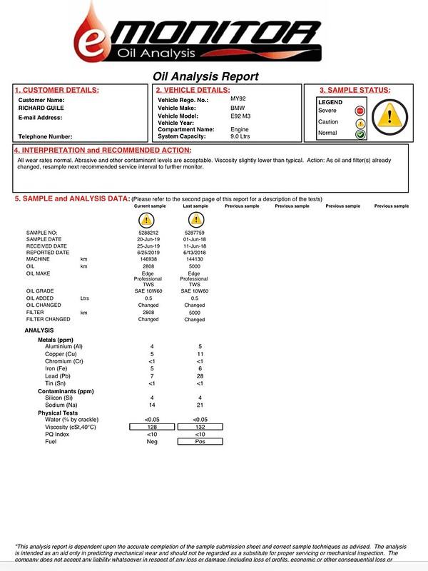

              I only put around 3k on it last year and about 5k the year before. I get the oil analysed with each service with the hope it will give an indication if the rod bearings are giving up. its not a conclusive test but it helps me sleep at night...

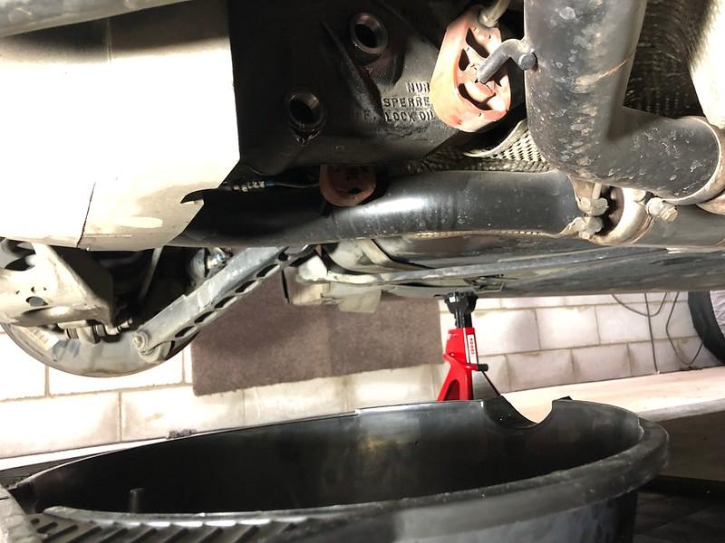

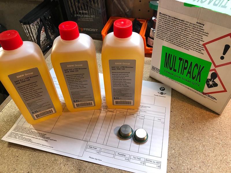

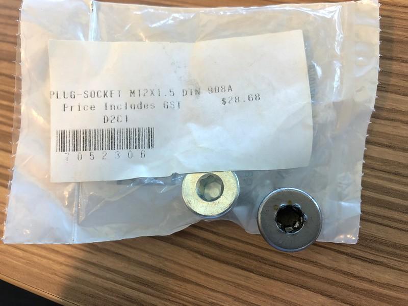

                I decided to refresh all the fluids starting with diff oil, of course I used OEM oil and fresh plugs with o-rings...
                both the top and bottom plugs out and fully draining the fluid...
                jacked the car up level and pumped it in the top until it was running out...
                time for another oil change and did the transmission too...
                OEM filter replacement also...

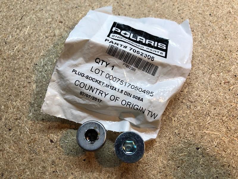

                I wasn't happy with the condition of the oil plug from numerous oil changes and didn't want to risk putting it back in so I went to buy two new ones from BMW. I couldn't believe it but they didn't have any in stock and I wanted to put my car back together so some searching on google later and local Polaris motorbike shop came to the rescue. spot the difference...
                $30 each for a drain plug is a bit ridiculous though...

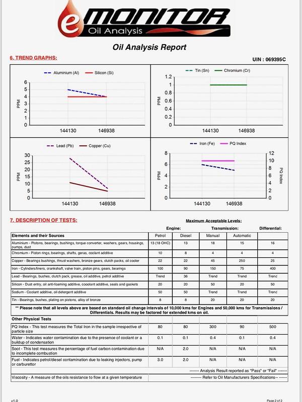

                12 months from replacing the fuel regulator I sent another sample off for analysis...
                the fuel presence has now gone which is good and I noticed that all the other measures are pretty much the same other than lead. the lead content has reduced a lot so maybe that was linked to removing the fuel...

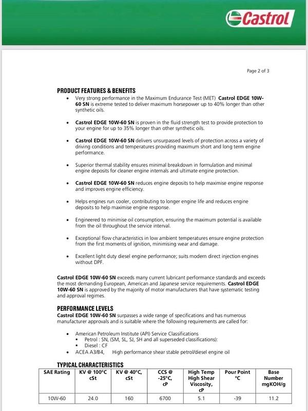

                I was curious about the lower viscosity reading, its not by much as the Castrol Tech Data Sheet states 160 at 40 deg c...
                so I emailed Castrol and received this response...
                funny how they thought I'd sent a fresh oil sample and then stated its not unusual for used oil viscosity to drop down. I'm going to move to 6 month oil changes now regardless of k's. it's a good job I don't listen to BMW's recommend service intervals as they'd have me driving to the moon and back before an oil change...

                      I would also not use the OEM supplied FM boosted diff oil. It increases diff wear, and causes an already slow diff to lockup even slower. Preface: all LSD oils basically have FM booster., that BMW stuff has a lot. The old formulations, SAF-XJ, SAF-XA have the minimum. If you don't care about noise/clunks, get that while stocks last. The reformulated LSD synthetics from Castrol: "Syntrax LS" has a bit less FM than the BMW SAF-XJ+FM Booster.

                        thanks for the tip on the diff oil, i'll definitely consider replacing it...

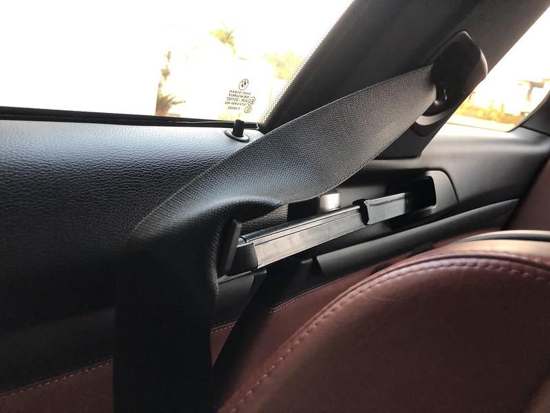

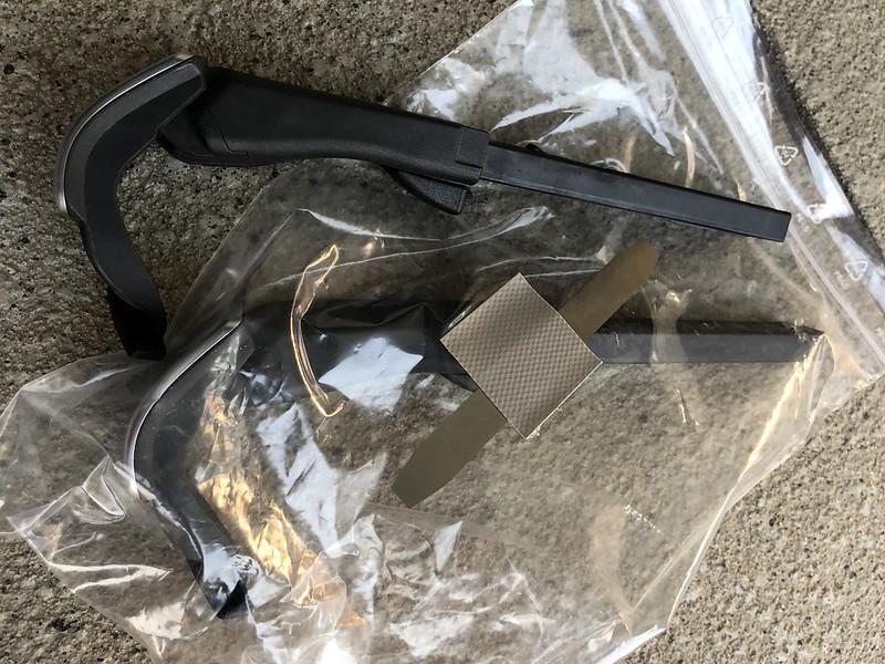

                          I decided to fix something that had been bugging me for a while so ordered this...
                          with the European left hand right hand thing I was a bit worried I ordered the wrong side but fortunately I had a win...
                          I wasn't too sure what the steel shim was for so I didn't use it but when I fitted the new seat belt extender it worked a treat, happy days...
