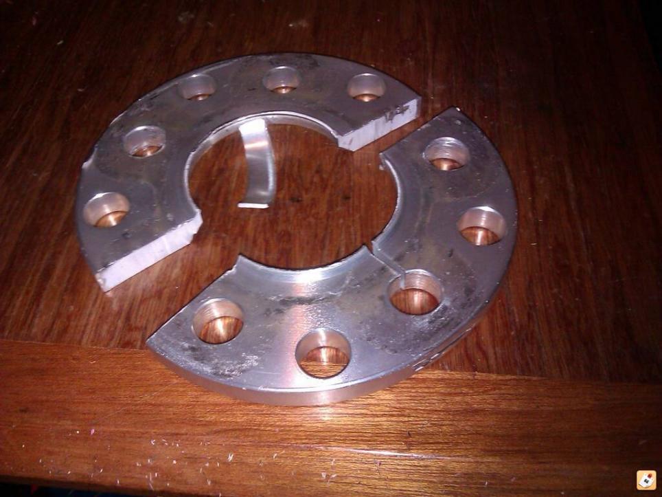

            Good stuff. This is what happened to my 10mm spacers on the mk3, which destroyed a wheel and was very lucky it didn't cause an accident...
            You can get spacers made locally at some machine shops and such, but is probably easier and cheaper to get some from overseas. Plenty of places that sell them. Would recommend avoiding Chinese ebay cheapies and buy from a reputable brand
