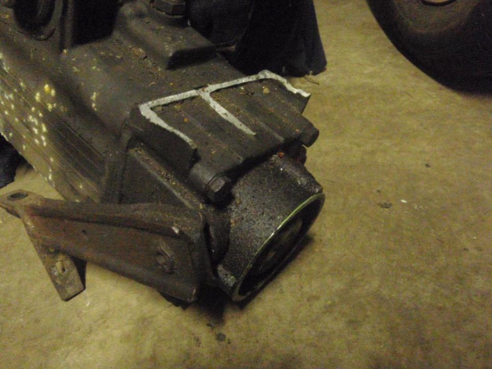

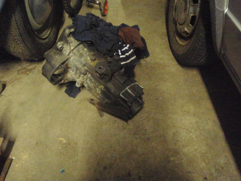

    Ok I took some pictures of the damage/part of the gear box i need.
    Anyone got that end area of the gearbox they can sell me??

          if its an early 5 speed ( from a Mk 1 ) then it may not have the extra support bearing for the driven gearshaft that the later covers have.
          You can use the later cover, however you will need to remove the needle bearing from the cover and machine, grind, chisel the inside of the cover where the needle roller is housed to avoid contact with the driven 5th gear.
          I bought an end cover $35 from Vortex and machined the bearing boss of myself (being a machinist with workshop has advantages )
          Good luck, PM me if you want pictures.

              Bolts are horizontal on a 5 speed.
              Vertical on a 4 speed.
              You will need a 5 speed mount too.
                Oh.....well now i feel dumb. I already have that part i think. I assumed the 5 speed attached the same way as the 4 speed, and didnt look at the rest of the mount. oooops.
                Thanks for clearing that up for me, Ill be in contact if i dont have that bit!
