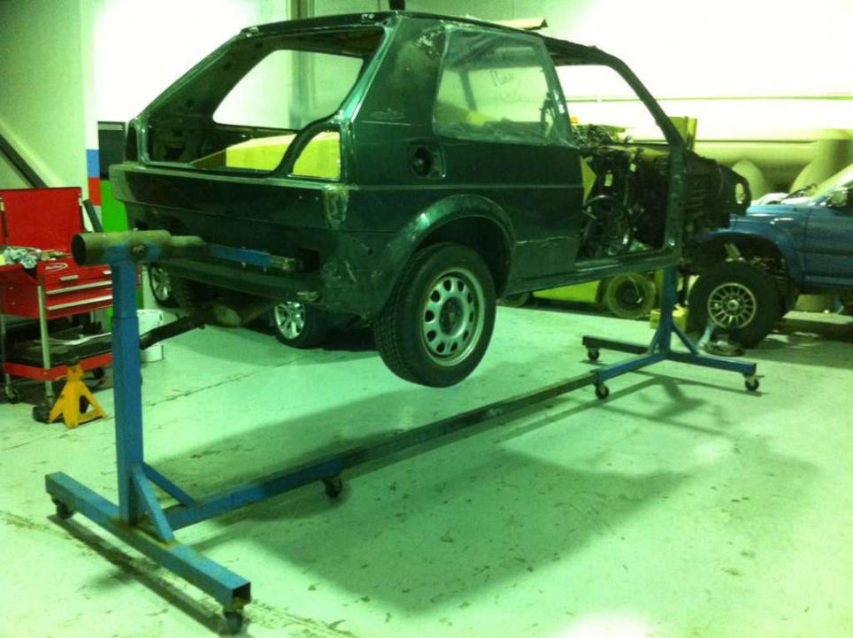

    umm dont know if i'd trust a $600 one. depends what you want it for and how often you will use it.
    this one cost me around $1100 in steel, bottle jacks and castors. it took a few weekends to make.
    but, it will drop to pick up a car, can be adjusted, and establish centre of gravity, and the you can spin the car round and round.
    oh, and it will collapse to pick up a fiat 500, or extend for a chevy, c1o etc etc.
    but most importantly, i am comfortable sitting under it or working on the car whilst in use,
    dont skimp on quality tools, especially when your legs may be under it.

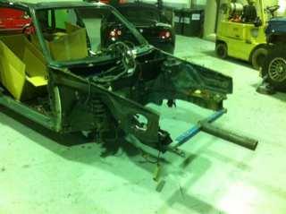

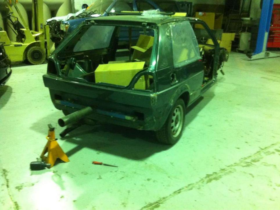

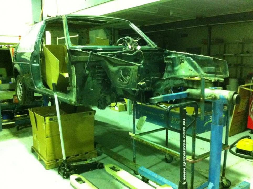

        No no car type, and correct you can't be on the cheap with this sort of thing ( or any tools ) I've managed to pick up a second hand one, made some changes, it's now adjustable to suit width, height and length
