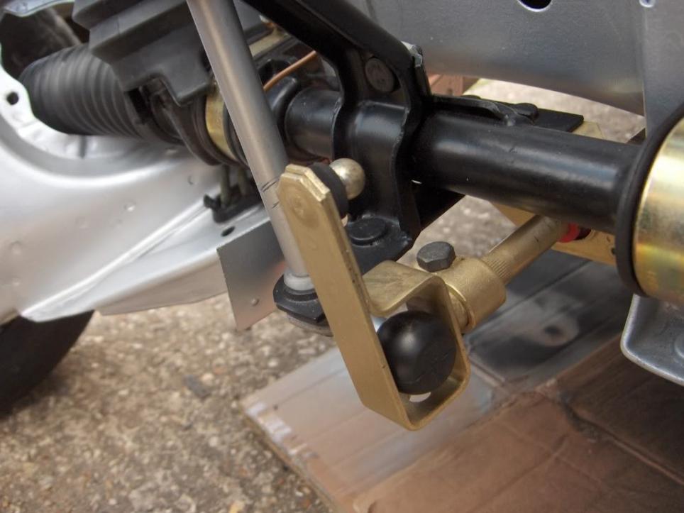

    Hi all looking for the 5 speed version of the following part
    also if there are any other parts I may have to change along with this please let me know.
    I have the larger 5 speed ball, and a set of 5 speed linkages.
    I am unsure whether the long metal rod in the linkage is any different on a five speed than a four speed?
    Thanks,
    Dan
    if all else fails, just extend that piece by 25mm,
    as for the gear stick, rod from that to that piece pictured above is the same, you just need to extend that piece, and get the rod that goes from that piece to box...

      Bump! also looking for the five speed versions of the last two parts in this photo
      cheers for the tip Dan might end up extending it if nothing comes to light
        Just modify 4 speed parts and replace the bushes and you will have a very nice shift
