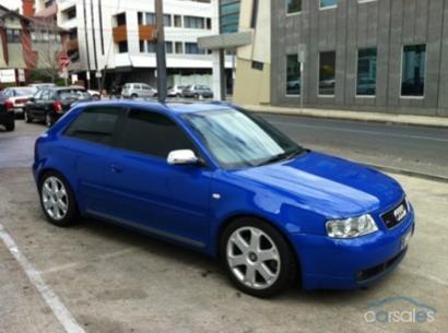

        How about my s3 wheels 17"

            - Thanks for that great info & link! I've had a look, and price vs. style wise, I think I'll be going for the R32 Reps at Tempe Tyres if I get brand new at the moment ($1400 with Kumho's). I'll still have another look or 2 there though.
