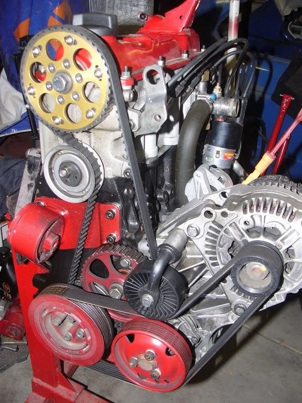

          Ill see if i can find a pic of what one i need.

            i'll help out and snap up a few pics of this one if you'd like
              This style/

                Yup that is the later GTI style mount.
                It has a bigger metal hoop than the one on your 1.6 mate and thus a bigger bushing.
                It also doesnt have the metal alternator bracket built in.
                The GTI Mounts come in different flavour, GTI, 16v Scirocco, Fast Street and Race to name a few permutations.
                You can buy all the different sizes of insert, but make sure you get the right one and have a press, or buy a new one with the bushing already inserted.
