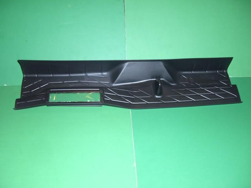

    Hoping someone has a rain tray water deflector so the water does not fall straight in on my coil, heater and other item living in the rain tray.
    Something like this.
    They only came on post 80 Mk1s Mik, all the early cars got a little tray only.
    You could always block the vents from underneath with a bit of plastic stuck to the bonnet, or make a metal tray like I did for that car.
      Might still be available as a spare part. Part number 171819415F
      I managed to buy a new one a couple of years ago from the US I think.
      The '79 GLDs all had them, they're mostly pretty stuffed now though.
      I usually run black silastic over the cracks and spray them black.
        Yet another part MIA Matt.
        Happy new year BTW!
          Snagged one off the webs.
