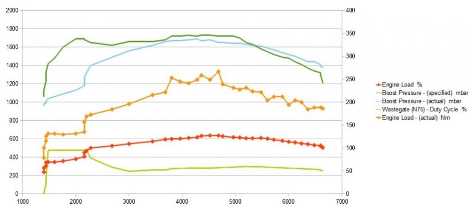

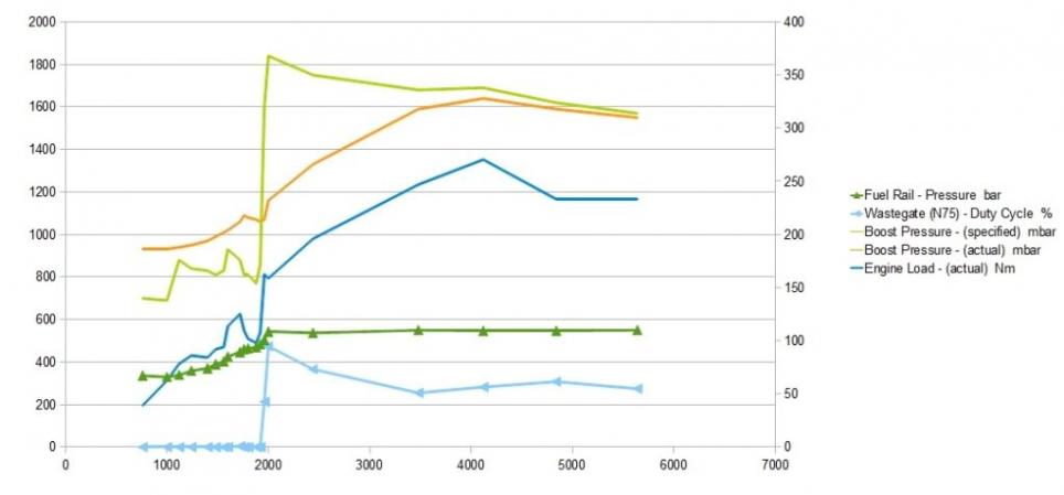

Two weeks ago I changed a Diverter Valve in my stock gti mk5.
The change made a huge difference but situation is back to abnormal again.
The car behaves like with faulty DV except I don't hear the whistle like before.
Here are some logs:
Any ideas?
