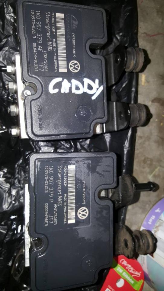

I need some help please.
To replace my half MFD red cluster with a white one I need to also replace my ABS controller
My car had a MK70 ABS unit consiting of a 1K0 907 379 P ABS controller with 1K0 614 117 H ABS module.
Coding was 0017025
(No TPMS and standard suspension)
I tried replacing with a unit from a Caddy but the brake lines was different so I ended up putting the Caddy controller (1K0 907 379 AF) onto my ABS module but couldnt get the coding correct.
On my cluster, both ABS and ASR lights are on
Current Coding is 16641 (it didnt want to accept 0017025 even if the values from 404 Not Found) adds up to that)
and error code is
01044 - Control Module Incorrectly Coded
003 - Mechanical Failure
Can anyone please help even if it means getting yet another ABS unit that will work?
Thanks
