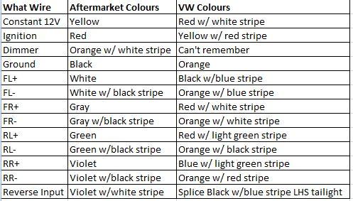

    I got bored of people asking about headunit change over so decided to make a how to, I'll attach the colour chart I made when I was putting mine in, and I'll write a proper how to another time soon with trim removal etc.
    I do know there are two of the same colour on the VW wires, but the speakers are on a separate harness to the power so you'll figure it out I'm sure
