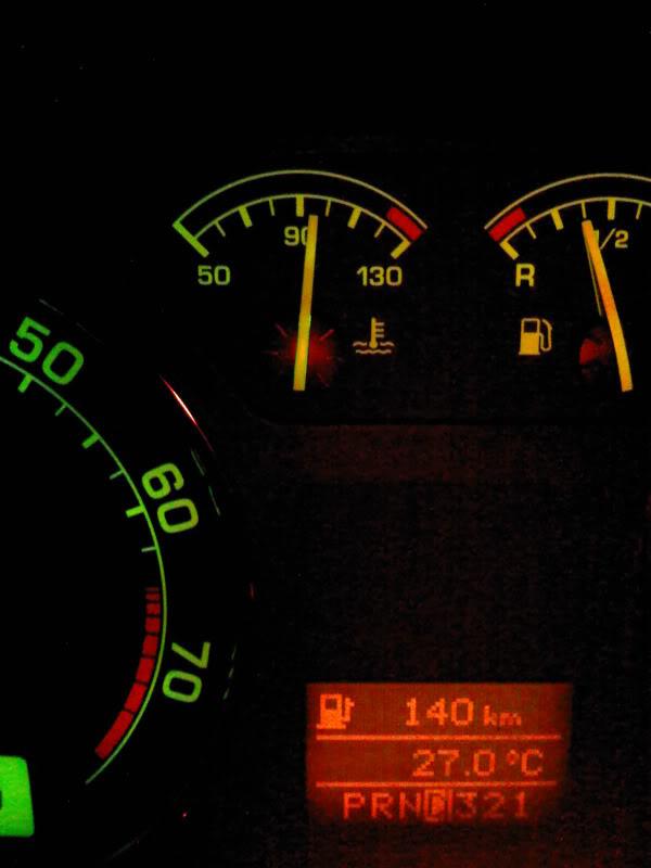

When I am at stop light the coolant temperature rise a little bit from 90º to 95º (Please check the photo) It does not rise more than that.
When I begin to drive, the coolant temperature go back to the middle (90º)
Also, one day that I saw the temperature in 95º, I turn off the engine, wait a little and then start again the engine........ The temperature goes to 100º and a few sec later go back to 90º

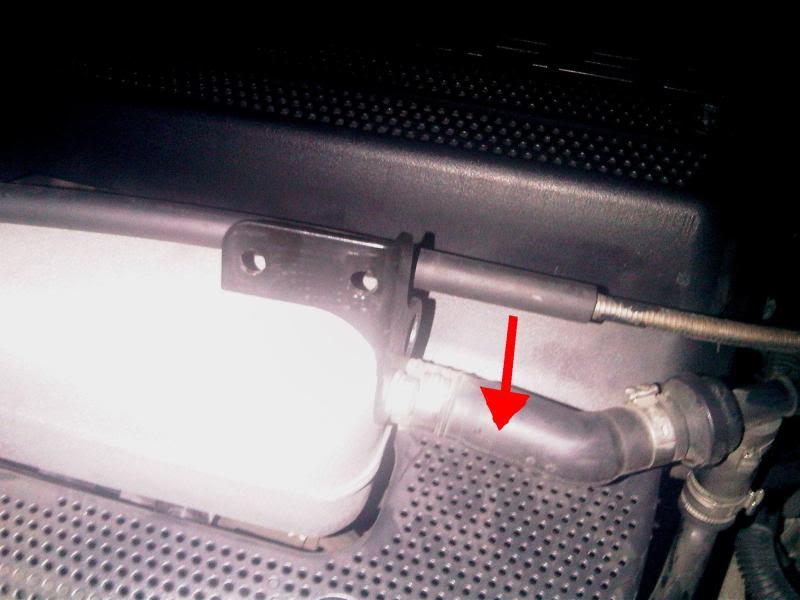

This problem happened after I took the car a weeks ago to the VW Dealer to fix a small leak on a coolant hose 1J0 122 109AQ that is near the coolant reservoir and when they gave me back the car, I notice they put me in a bag the damage hose part + two empty G12++ Coolant 32onz bottles.
I was curious because I am pretty sure when the replace that small hose some of the coolant loss on the floor and they need to add more but I was think that maybe one bottle plus water was enough...............So when I ask the mechanic guy, he says he put the 2 bottles and they do not mixed it with water and that this is OK

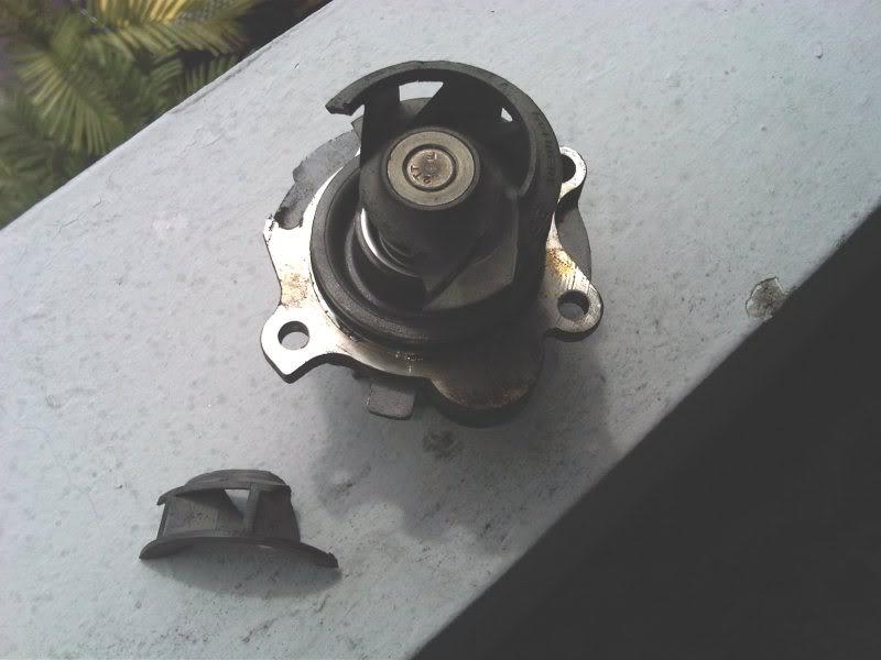

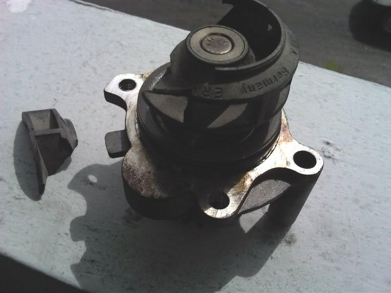

Here in my country the weather is very hot. I know the G12++ Coolant has to be mixed 50/50..............Can this be my problem that the coolant temperature rise a little........ Or this can be a symptom of a water pump that the plastic impeller is going to fail
