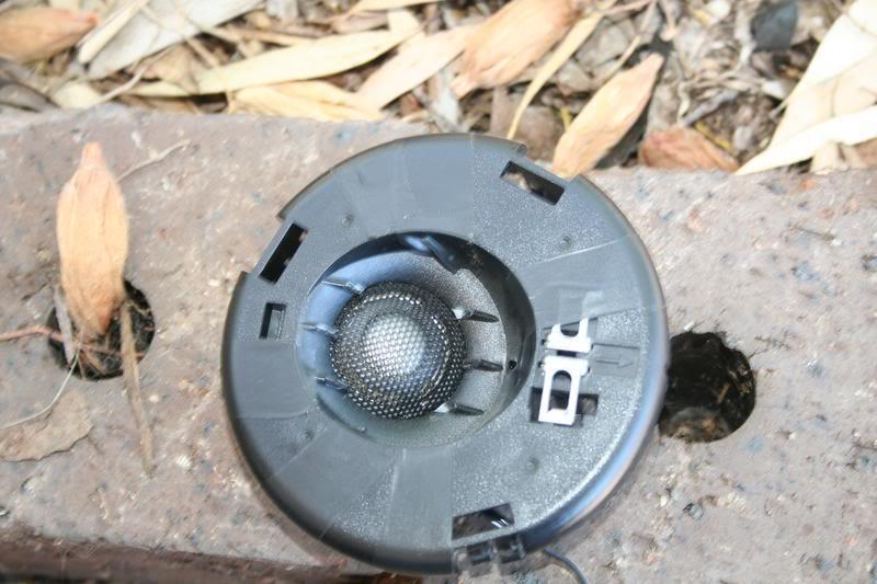

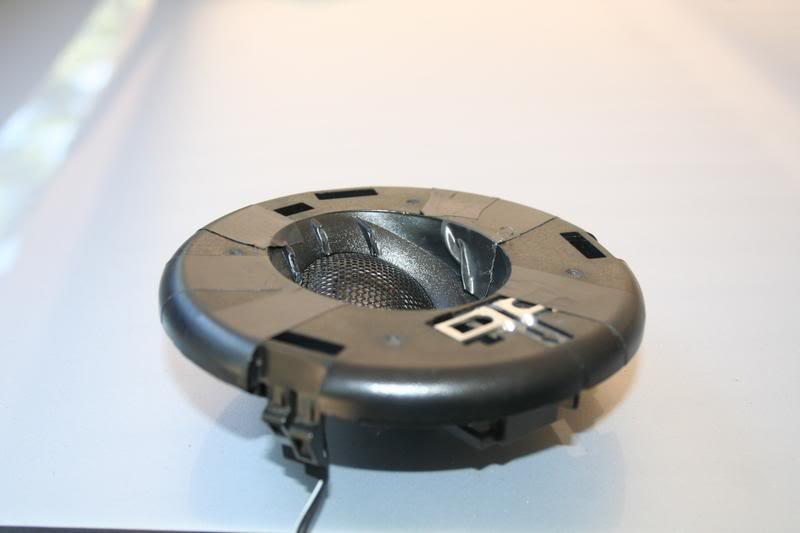

                  I'm going with coons88's idea for mounting the tweeter, except when i finally got the original one out, i found 2 sets of leads in there. What do they connect to?
                  I noticed in the door speaker there's another set that leads to something as well but it's been taped up, i guess by whoever changed the head unt..
                  Dazzled, i thought there was no crossover in the original system
                  I'm leaving the original cabling in there, so i can easily refit the original speakers when i sell it.
                  It'd be nice to know what they connect to instead of yanking things out randomly
                    The cross over is built in to the factory speakers as far as I am aware
                    I would recomend that you run new wires through the door up to your tweeters, and as you say, leave the factory wiring alone so you can swap it back to standard easily. That is what I did
