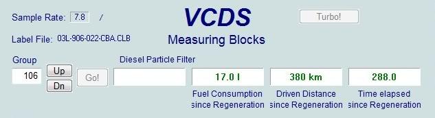

Data obtained via VCDS from Engine, Measuring Blocks 106 & 108:
General Info - Shows at least 380km between passive regens

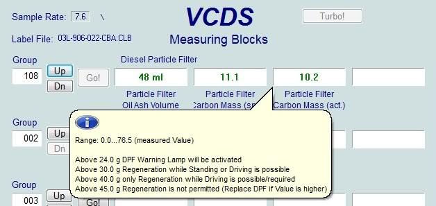

DPF had 10g of carbon, a smidge under half that needed for DPF intrument light to appear

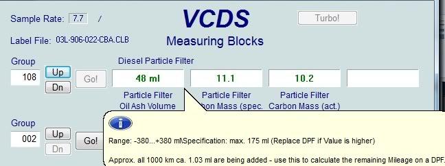

DPF had 48ml of irremovable ash. 175ml suggests replacement needed (so mine was 28% full). Further information in VCDS suggests a nominal DPF lifespan of 170,000km. Using the ratio given, 48ml of ash suggests a milage of 49,000km yet mine was 85,000km at the time (so with the same usage & soot production, projected lifespan of my DPF would have been 305,000km
). Not too bad I suppose. Good luck for owner #2.
