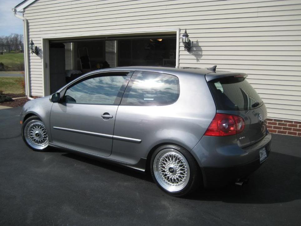

                        MkV's look hot on the BBS rs even 17s, 1 issue is finding a high enough offset.
